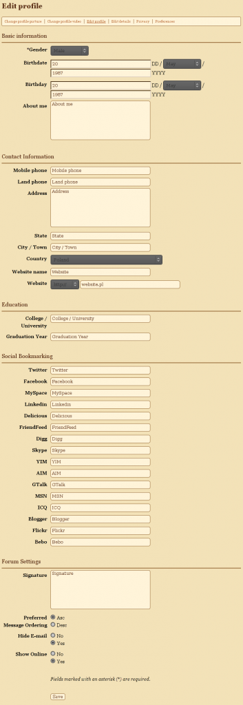

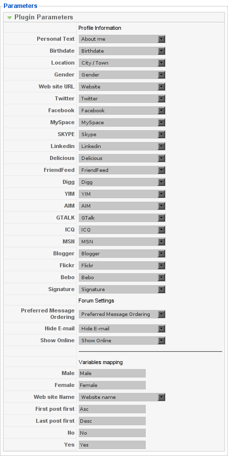

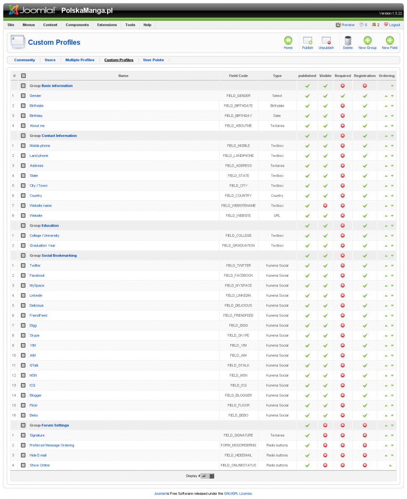

I wrote system plugin and additional JomSocial field type, that should help to integrate user profiles between JomSocial and Kunena.
Example JomSocial fields:
Example system plugin configuration:

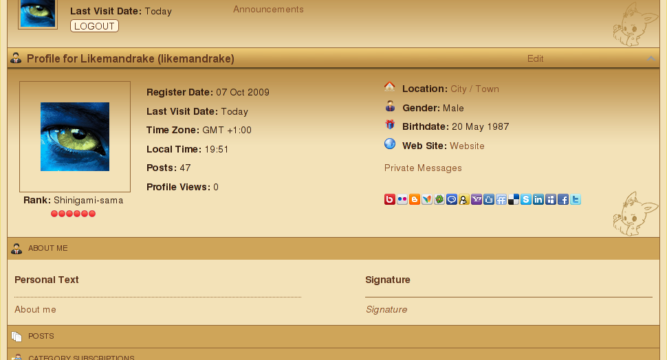

And effect on Kunena profile:
