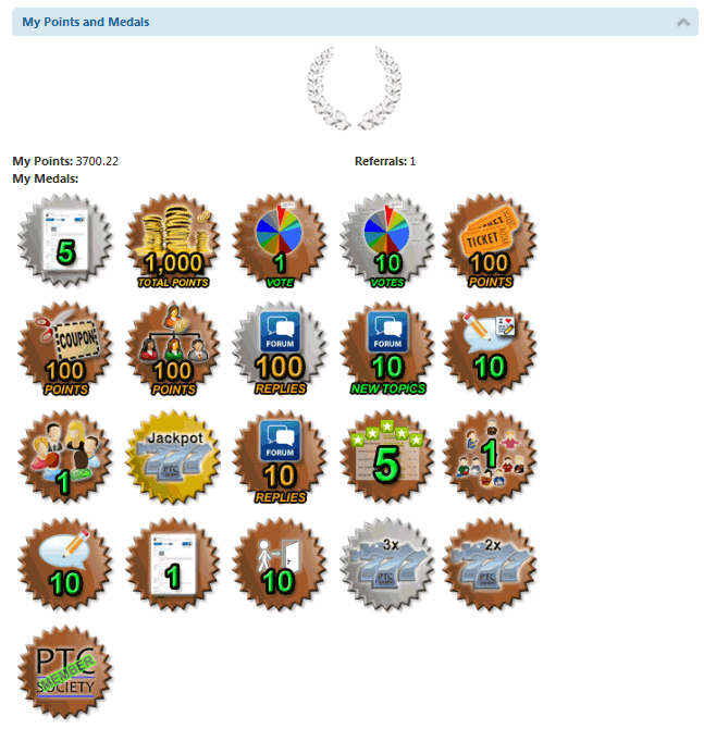

It looks like this on my members profiles:
I use:
Joomla 2.5.4
Jomsocial 2.6.0
Kunena 1.7.2
AUP 1.7.2
That's the only solution i can offer.
